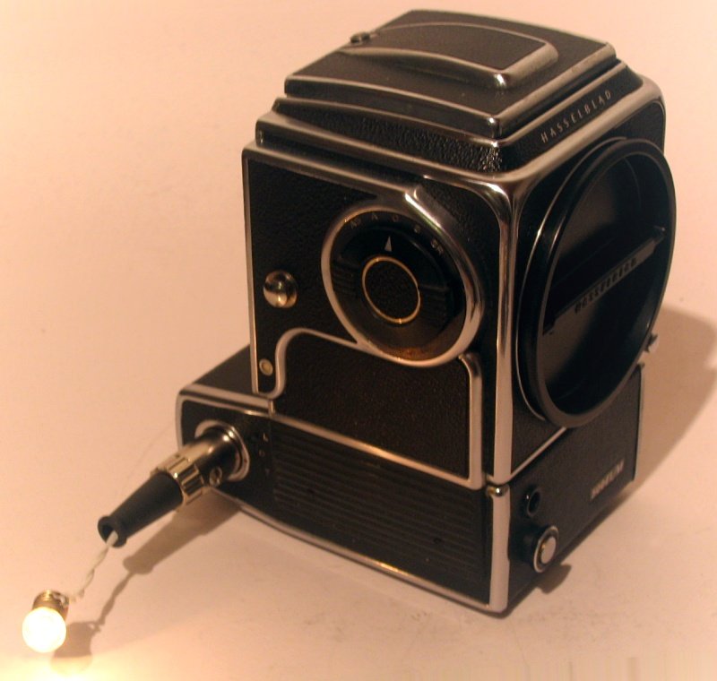

At least for cameras as old as Methusalem we had a decent plug to connect the bulb to drain the battery before charging.....
