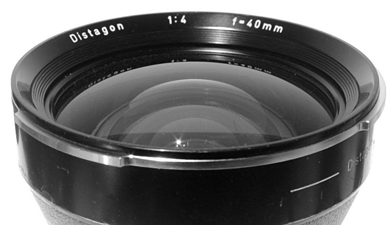

40mm C lens front element.
Do not say Marc and I did not warn you:

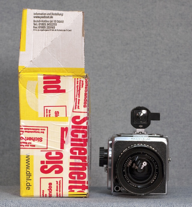

Two users here deserve special recommendation for the quality of their packing.
Funny thing is they both are and were into IT business.
Wilko and Jürgen will beat the highest grade mil. spec. in packing.
Imagine what it means to one of those guys to receive this:
Shoebox SWA camera
Quite a disappointment when it took more than a year to find that camera.
