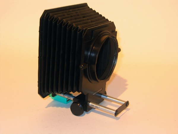

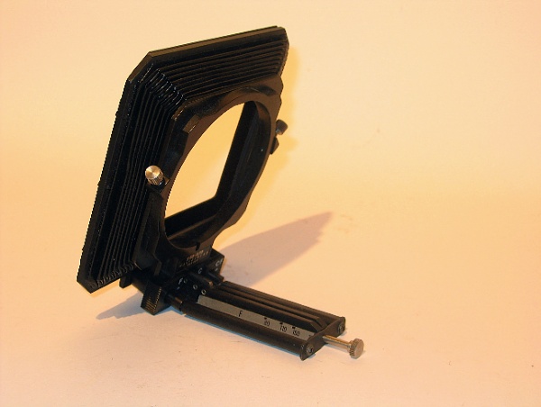

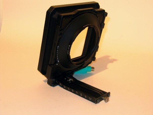

first model 40231
second model 40676
third model 6093
There is also a fourth design mainly intended for use with Fuji lenses for the H series.
That is the 6095 model more plastic and a larger opening to accomodate Fuji lenses.

There is a fifth compendium similar to the 40676, the last in the series.
It has part number 40726 and will accept 93 mm lenses.

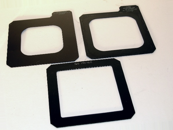

Three masks, bottom 120/135/150, top left 250, top right 250F/350CF/500CF
