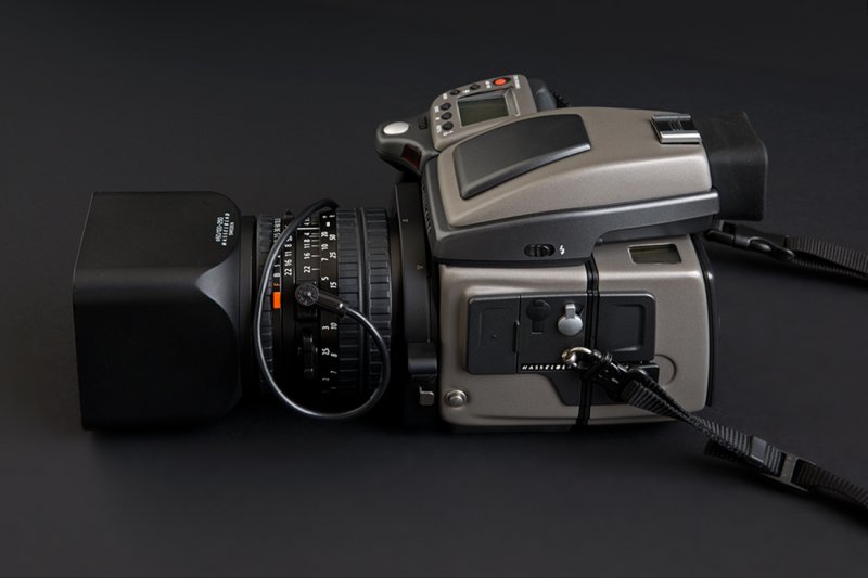

This is a photo of my H2F with the CF adapter mounted using a Zeiss 100/3.5 CFi ... while the HC system offers a 100mm focal length, the Zeiss 100 produces a different signature ... so for me it was worth it to keep both lenses for use on the H cameras.

the Ziess 65/3.5 CFi seems interesting but where can I find it in Europa ??
I have actually only HC 35,80 and 210

Well Erick, I can't help with European places to buy used Hasselblad/Zeiss lenses .... but here in the USA almost every internet dealer has a good stock of V lenses. Some will ship to Europe I think.
The question becomes whether it is cost effective to buy the CF Adapter for just one lens like the 65/3.5. I have 14 Medium Format Carl Zeiss lenses in the V mount, and 10 of them will work on the H camera with the adapter (the other 4 are 200 series lenses without the central shutter in the lens for use on the focal plane shutter Hasselblads.) So, it made sense for me to get the CF adapter.
I think it's worth it for use of two or three V lenses that aren't available in the HC line. The Zeiss 40/4 IF, 65/3.5, 100/3.5, 180/4, and 250SA are examples of legendary optics not found in the HC line-up. Most all of the lens accessories for the older Hasselblad V system will also work with the CF adapter. The 1.4X, 2X and 1.4XAPO extenders work and are listed in the choices on the H camera grip menu when you mount the CF adapter.
