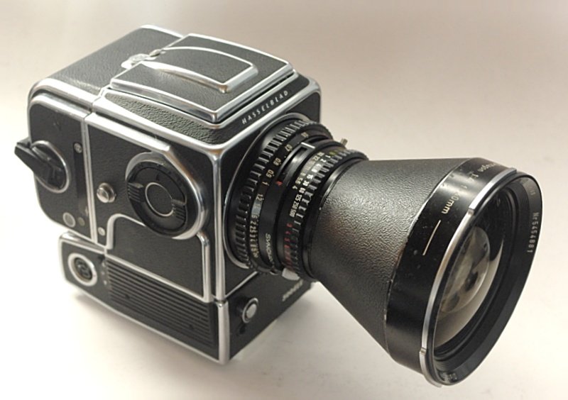

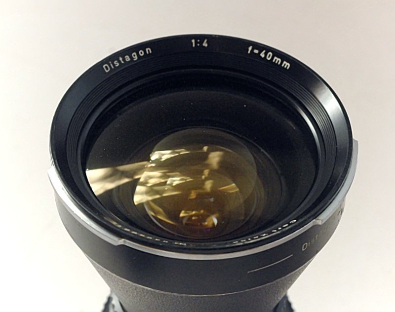

I am quite happy using my 40 mm C lens. It also saves me some money for the gym!
Massive front element
Good set for a work out!
Joking aside, I think this is what worries me the most in terms of the 40mm - if it's just too big or heavy, I'm unlikely to want to take it with me - which is why the compact nature of the SWC appeals more and more...
