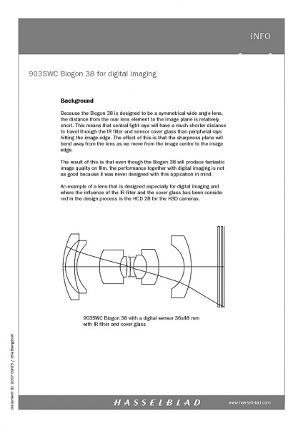

With Hasselblad's advice in mind that the performance of the 38mm Biogon can be compromised when used with digital backs, I'd be very interested to hear of user's 'real world' experiences with the SWC series and digital backs and in particular 36x48 backs.

That's new information for me Keith and I can say that I'm surprised and disappointed by it. I'm of the opinion that the output from the lens and back is superb, but I'm not measuring it with an electron microscope.
I suppose that with bigger backs it may become a problem, but with the cropped CFV, it's not been a concern.

Hi Gary,
No need to be disappointed.
I do not say Hasselblad is incorrect but in practical use the problem is not as bad as it looks.
You are right that the reduced size of the CFV is to be considered.
In fact the problem arises from the reduced distance between the rear lens of the SWC and the sensor surface.
This means the angle of the light at the edges of the sensor is quite small compared with bodies that use a mirror.
Sensors perform best when light reaches them at 90° angle.
So far even larger sensors than the CFV have given no real problems when used with SWC cameras.
Some manufacturers even state the SWC optics are no match for their sensors.
These guys have got their arithmetic all wrong.
The SWC outperforms any digital back on the market right now!
Your images are proof of a good marriage between the SWC and the CFV digital back.
