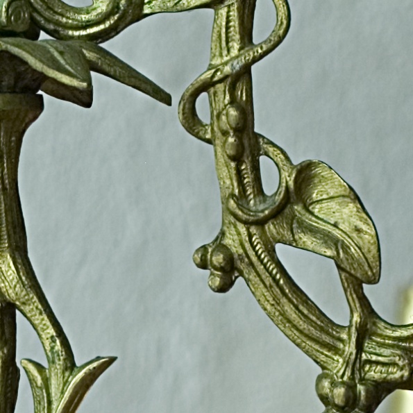

Here is a test of a brass chandelier detail. the image is 1:1. Its 600x600 pixels cropped out of a 4072x4072 picture.
