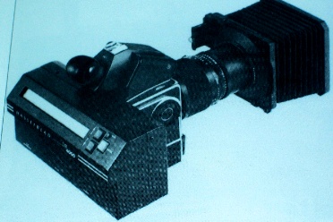

To give you an idea what an early back looks like and what it does to a camera here a snapshot that I took from a sales brochure.

Good grief! Very.....early James Bond :) Would you happen to know the model name of the Kodak back you're referring to? Is it the Kodak DCS Pro 16Mpix?

I knew you would be in for a surprise!
You are right that is the Kodak back I was thinking of.
I have not got a picture of the Kodak back but I promise you it looks quite decent behind a camera.
No resemblance to the early Leaf back I shocked you with.
Please note this early back is a little over 20 years old.
It shows how fast digital developments have made progress.
The double top hook of a body is not strong enough to hold these early backs.
They are fixed by means of the studs on the body that are normally used for the camera strap.
A true dinosaur....
