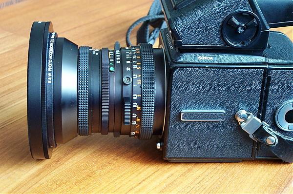

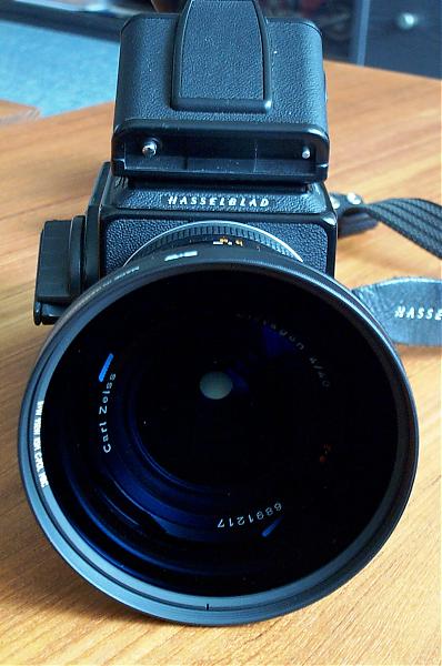

The stepup ring has arrived today all the way from California (bought on eBay). It fits nicely and the result sure looks scary. The fact that this is an EW (wide angle) version filter explains the large diameter (115mm).
All in all I can recommend the overall solution, a 95mm screwmount filter plus a step up ring are a viable and cost effective solution, which saves you from hunting down a rare Hasselblad filter.
Assuming you acquire a circular pol filter it is even future proof should you ever succumb to the sirens (read: go for the H series).
Our esteemed moderator has acquired a non-EW B+W 95mm pola, I am sure we will soon hear how well that works using a stepup ring.
Now if only these darn rain clouds would dissappear...
Side note: the screwthreads on the original Hasselblad 93mm ring are NOT 93mm. The 93mm refers to the diameter of the drop-in filters. Caveat empor.

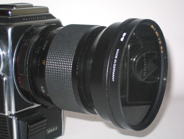

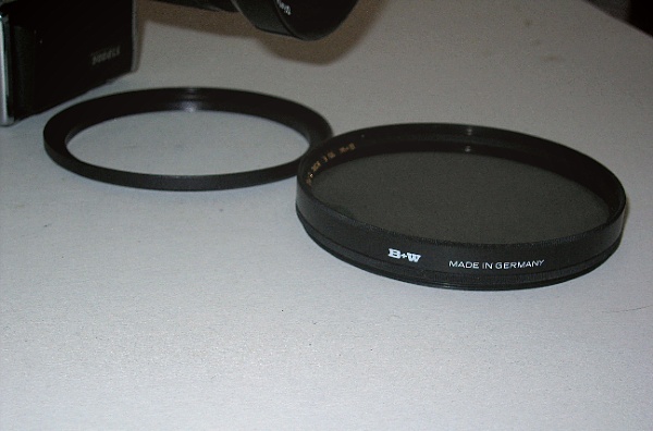

I have used one of those to fit a 95 mm polarizer on a lens with 86 mm thread.
The following Hasselblad lenses have 86 mm threads:
40 mm CF/CFE, 50 MM F/FE, 350 mm C and 500 mm C.
To make the 86 mm thread available the shade from both the 40 mm and 50 mm lenses needs to be removed.
It may be safe to go for the 105 mm filter size with the 40 mm WA to prevent vignetting.
An adapter also expands the possibilties to find used filters of course.
Heliopan filters: http://www.heliopan.de/Heliopan-Filters.pdf
Interesting to read not only what is available but also Heliopans research for
better coatings.
50 mm F lens fitted with 95 mm Polarizer from B+W
Adapter and filter
