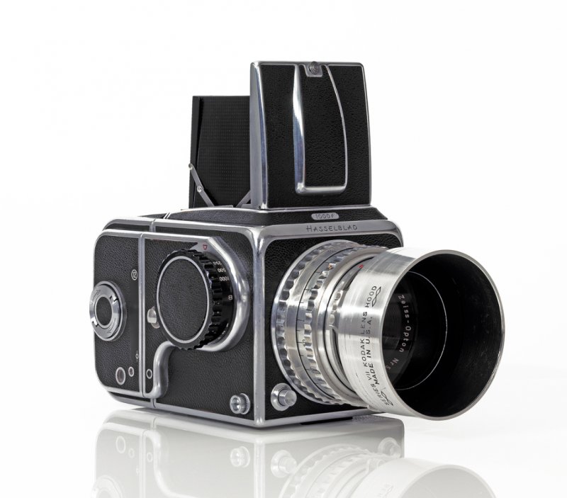

1000F rebuilt. Photo by Jürgen Loob, owner of this beauty.
This camera was rather nice the way it arrived with Jürgen.
He wanted this 1000F fully serviced.
Being Jürgens camera my technician decided to replace most external fittings with new or near mint parts.
Of course that had some influence on the total amount of the service job.
The result is one of the best original 1000F cameras around.
Coming from horrible Russian contraptions, by some optimistically even called cameras, it is a relieve for my friend who performed this service to work on Hasselblad cameras.
Once soughted out by him they perform with about the same reliability as later 500 series bodies.
My 1600F and 1000F cameras have yet to fail on me. KOW!

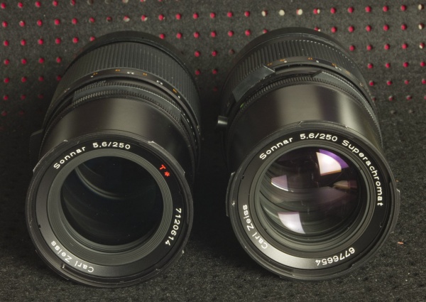

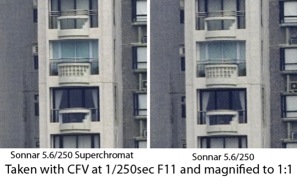

I owned two 250mm lenses for my Hassy V-system, Sonnar 5.6/250 T* and Sonnar 5.6/250 Superchromat. Although Sonnar 5.6/250 T* is already a very good lens, however, residual chromatic aberration can still visible which lack the extreme detail as provided by the superchromat. In fact, because of the need of making four spectral lines to meet, the superchromat is the only CF lens that cannot use T* coating.

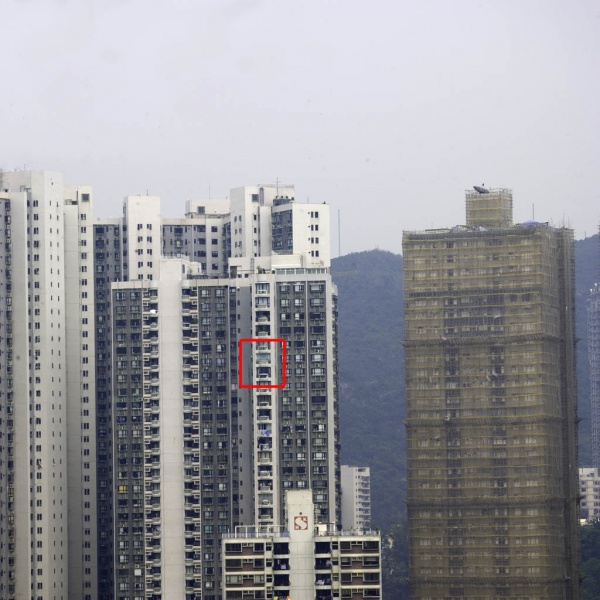

Pictures taken by both 250mm lenses with same exposure on a 205TCC and CFV back.

Thanks for these images.
It seems you have done your homework quite well.
The superachromat can not use T* coating in fact it does not need it because it is superior to the Sonnar design in many aspects amongst which colour rendering.

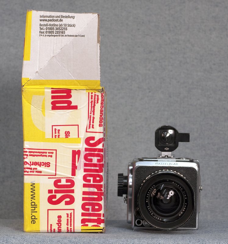

Shoebox SWA, damaged in transport.
Much to Jürgens regret.
He found this one after a one year hunt.
The seller pointed at the shipping company.
GLS just laughed at this claim, they were right of course.
Unsuitable packing of a vulnerable camera is the cause for this transport damage.
Stupidity seldom comes alone.
It took a couple of bright letters from the buyers lawyer and probably a session with a lawyer at his end to convince the seller he had better refund all expenses including the lawyers bill from the buyer.
Would you believe this seller owns a camera shop?
There is simply no end to the stupidity of certain members of the human race.
