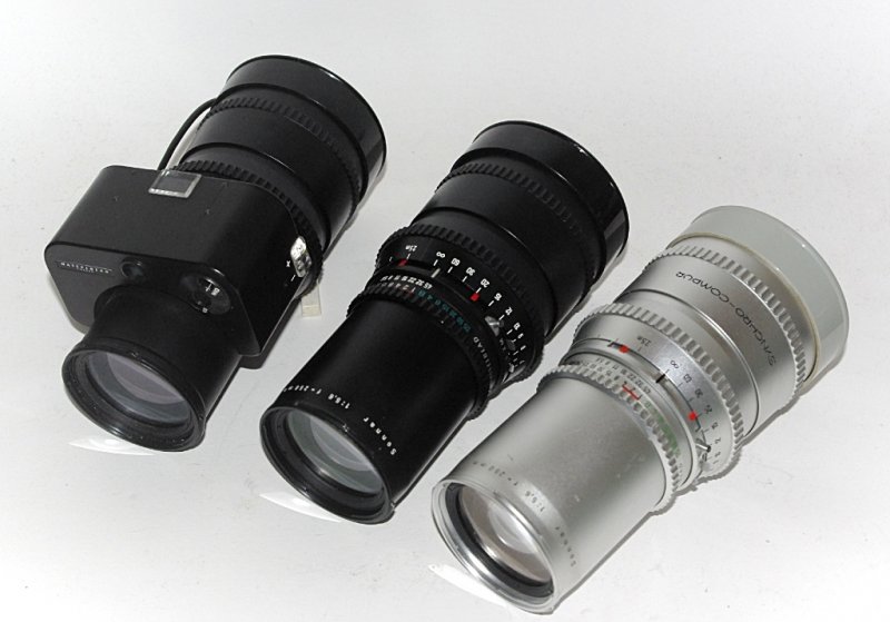

The 250 is a much underrated lens. Maybe its size has something to do with that.
It is one of the oldest designs for Hasselblad with roots going back to the pre 500 series bodies, 1600F and 1000F.
Glass for a the latest 250CFi will fit the earliest silver C lens.
Proof is the silver lens in the picture. It was converted to T* using lens elements produced for a 250 Cfi.
Left 250 with aperture control, center black T*, right rare silver T*
A pity the 250 SA lens was not at home today.
It would have made this family pic complete

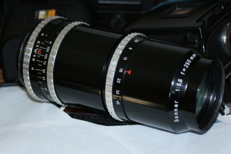

Here's my latest (oldest) 250mm...........

Ohhhhh Terry
That SONNAR looks as if it is new .
I envy you for that wonderful cannon .
Oh , I forgot to say , and Paul knows about that , I am an absolute freak of gear , which looks and is mint or even better . I know , that passion is hard to be fullfilled , but patience is the mother of success here .
