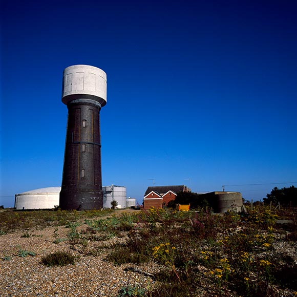

take this image for example, I am really upset at how the tower tends to lean to one side, plus it is a bit barreled as well....
I know the way around this is with view cameras, but I have seen the Mamiya 43mm on a rangefinder (mamiya 7) and it is outstanding, I am looking for something like that...

I feel you might be comparing apples to oranges in the way you are assessing the Zeiss 50 and Sekor 43. In your posted image, I see the light house lines converging inward, indicating that your wide angle lens was pointed upwards. The only remedy to this problem is a shift lens. All wide angles, including the Mamiya 43mm will yield similar distortion under the same circumstances.
FYI - the Mamiya 43mm lens is actually a copy-cat design of the Zeiss 38mm Biogon, found in the SWC series cameras, which is why it performs so well at the edges. If you are trying to stay with Hasselblad V system lenses, perhaps one of the SWC bodies is what you need.
