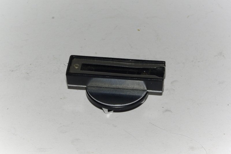

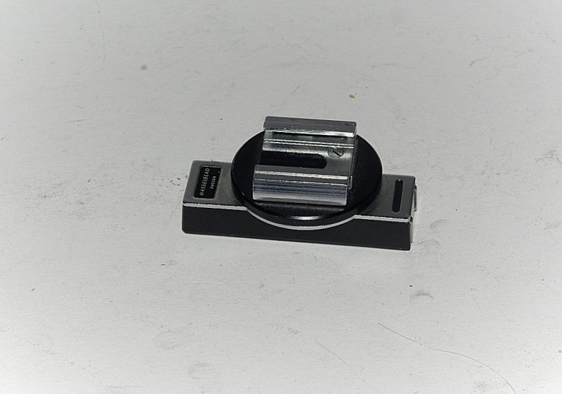

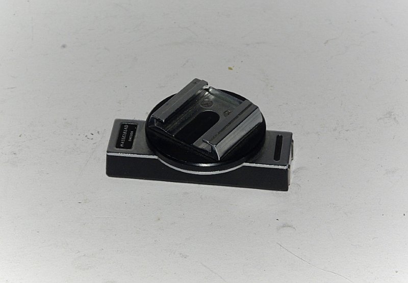

There is an adjustable flash shoe available (HASSELBLAD number 43125) .
This item is not produced any more , but can be found quite often on ebay .
That shoe can hold the VOIGTLÄNDER VC lightmeter .
Might be that Paul (moderator) can supply an image of that adapter .

Flash shoe adjustable
This clever little thing slides over the accessoire rail at the left side of the body.
It holds all kinds of items from a small flash unit till meters like the VC.
Available from stock!
Contact me PM if you want one.

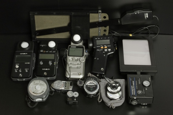

I use all these for different purposes.
1. Color meter, Gossen Sixticolor and Minolta Color Meter II, for checking correct color temperature and correct color correction filters required. This is particular useful for color reversal film shot;
2. Spot meter, Minolta spotmeter, for visualizing contrast of the scene. This is particular useful if you use Adams Andsel's Zone System;
3. General purpose exposure meter, Minolta flash meter IV and Sekonic L608, these meters can take incident reading as well as reflective reading. The incident reading is taken to the subject and making use of dome to reduce exposure by 2 stops, this is particular useful for reversal film and digital photography;
4. Various clamp on meters, Leica MR-4 and Pentax Meter, for integration with camera that has no built-in meters;
5. Miniature meters, like Sekonic Twinmate L-208 and Voigtlander VC-2, are non-bulky and handy for taking casual reflective measurement;
6. Spot metering and average metering for Large Format metering can be taken at the film plane by Sinar Booster 1 (to use with Minolta Flashmeter IV) and Horseman Exposure Meter 45 respectively. This is particular useful for macro-work where bellow factor can be forgotten.

Hello Doug--
Do you use a llama or some other means to get to the scene? Gosh, I thought that I was meter poor but I can't come close to your selection.:cool::lol:
