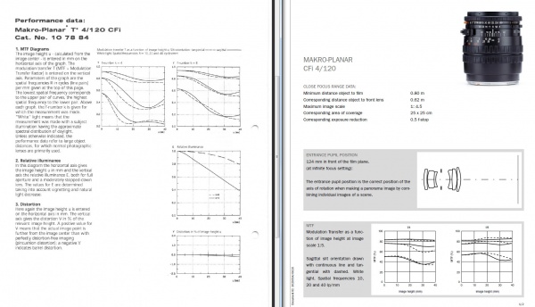

The lens area of Zeiss' site shows the CF and CFi 120 Makros as having identical, but significantly poorer MTF than the CFE version of this lens.
I double-checked the V area of Hasselblad's site, and they show the CFi as having the same MTF performance as Zeiss shows of the CFE. (I've attached a screen shot of Zeiss' CFi 120 MTF and Hasselblad's CFi 120 MTF.) As you can see, there's a bit of disagreement here...
All datasheets show exactly the same optical formula--I'd not have expected to see such a dramatic difference from simply improving internal flocking etc. In fact, I'm at a loss to explain any difference in the MTF's at all, let alone a discrepency for the same CFi lens (unless someone has simply posted the wrong graph).
Anyone have an idea?
(Zeiss' CFi 120 PDF was too large to attach, but you can see it here.)

I have checked The CZ information on the CF and later CFi/CFE versions.
Large differences do not make sense as all versions concern the same design with the same glass.
All lenses have the same glass elements with the exception of the rare 120 CB lens.
That lens has a different front element.
The 120 Makro Planar shows nearly a full circle: from CF to CFi to CFE and back to CFi again.

Can you please expain the differences between the glass elements of the 120CB and 120CFi/CFE?
I always thought they are exactly the same...
On photo.net I found that statement:
"The Makro-Planar CB 4/120 is optically the same as CF 4/120 or current CFi 4/120. However, in a shutter mount without the "F" mode, i.e for use on the focal plane shutter cameras of the 200 series. It has so far been available only in a few selected markets, and then usually as part of a package.
Regards Torbjorn Eriksson Customer Relations VHAB Sweden"
(http://photo.net/medium-format-photography-forum/000R1E)
BTW: What does "rare" mean? Do you have any number at hand? How many of those were made?
