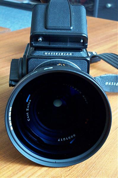

I just got lucky, and bought myself a absolutely mint B+W 95EW circular polarising filter. :z04_sabber:
<snip>
The stepup ring has arrived today all the way from California (bought on eBay). It fits nicely and the result sure looks scary. The fact that this is an EW (wide angle) version filter explains the large diameter (115mm).
All in all I can recommend the overall solution, a 95mm screwmount filter plus a step up ring are a viable and cost effective solution, which saves you from hunting down a rare Hasselblad filter.
Assuming you acquire a circular pol filter it is even future proof should you ever succumb to the sirens (read: go for the H series).
Our esteemed moderator has acquired a non-EW B+W 95mm pola, I am sure we will soon hear how well that works using a stepup ring.
Now if only these darn rain clouds would dissappear...
Side note: the screwthreads on the original Hasselblad 93mm ring are NOT 93mm. The 93mm refers to the diameter of the drop-in filters. Caveat empor.
