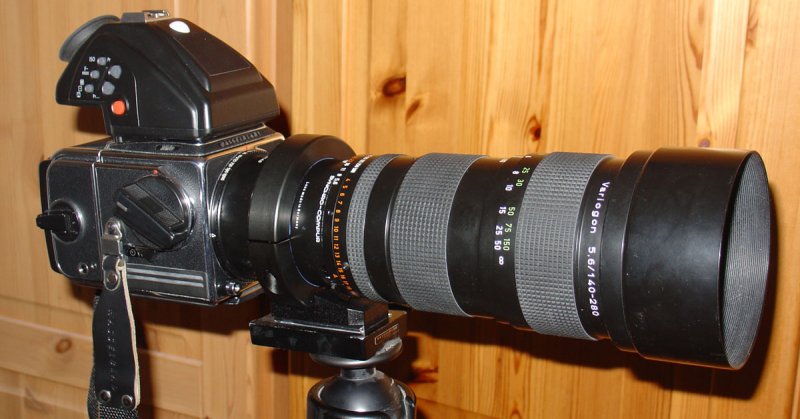

Hello,
let me just add a picture of that recently purchased lens. As it is a C-lens it did not come with a tripod mount like the CF-version. But I was able to find an aftermarket mount made for this lens which features a foot that fits the Hasselblad quick release. It is more substantial and more gentle to the lens than the original Hasselblad mount that was once available.
Now that's what I'm talking about! Why anyone would manufacture a lens of this proportion without a tripod collar is a mystery to me. Looks well balanced now.
I forgot to mention that I also bought a very similar tripod mount for my 5,6/350 mm CT* from the same supplier. Especially together with a teleconverter this was too unbalanced even for a ArcaSwiss B1 ballhead. And I am not sure if the strain is good for the camera bayonet either.
