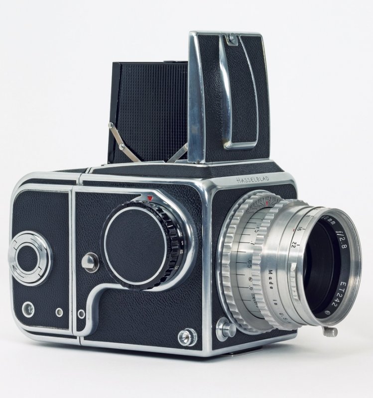

First of all I forgot to mention that Hasselblad cameras are not meant to be stored but to be used.
If for any reason a camera or lens needs to be stored for a longer period of time it is better to release the mechanism.
Cocked lenses and bodies have loaded springs.
Those springs can withstand being loaded for a long time without problems.
Do not overdo it!
My 1600F was stored over 45 years in spring loaded condition.
The shutter springs needed replacement but that was about it.
That camera is in perfect working condition with new springs and fresh oil.
"A thing of beauty is a joy forever."
1951 1600F with 80 mm Kodak Ektar lens
Camera and photo Jürgen Loob
