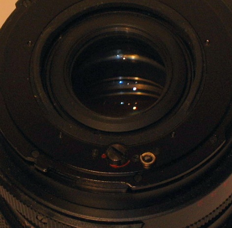

My friend has a Hasselblad 80mm F series lens and I can't mount it on her 205tcc camera. The little sync bit on the lens (not sure what it is actually called, but it looks like a phillips head screw,) won't match upto the male part on the camera. All her other lenses mount properly.
Any suggestions on how to fix this?

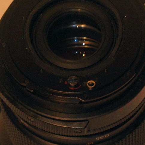

The lens is probably simply released. Check the position of the slotted shaft.
The left picture shows the correct position for a lens ready to mount on a camera.
The right picture shows a lens in released mode. The slotted shaft does not align with the drive shaft of the camera.
lens with slot in charged position.jpg lens with slot in released position.jpg
To correct this simply take a small coin and turn the shaft clockwise untill it locks.
If all is well the slot stays in the position of the first picture.
The lens is ready to mount on the camera.
Please use a small coin and do not use a screwdriver.
If the screwdriver slips you stand a good chance to damage the rear element of the lens. :z04_head_wall:
If you are experiencing a different problem the bad news is the lens needs to be serviced by a qualified technician.

Sweet, thanks mate! I didn't know it would be so easy. It's now on the camera.
