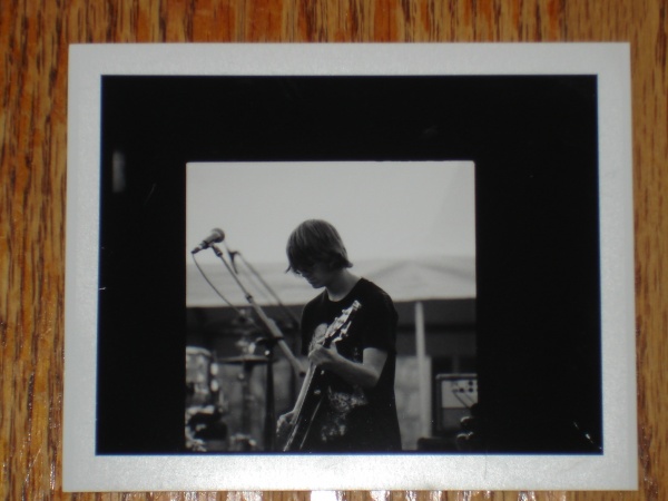

After I finished the Delta 3200 in one one of my A12 magazines, I put on my NPC Instant back and shot an instant frame of Fujiroid400. Showed it to the band afterwards, they were -amazed-. How did you get that so quickly??? I really enjoy Instant photography. Another outdoor concert tommorrow, I will probably take my Rock setup out once again.
With the 350mm Tele-Tessar @ F5.6 400 Fujiroid:

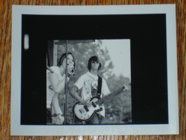

Here's one from yesterdays concert, also Fujiroid400, with my fave 350mm F5.6 Tele-Tessar on 500C/M:
