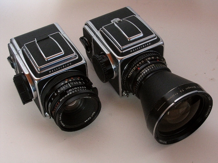

Different generations of lenses and bodies:
Left: Later 500 CM with CF style 80 mm lens.
Right: Early 500CM body with C series 40 mm lens.
This 40 mm lens has seen two newer generations now but these large wide angles are still being used
despite their expensive filter size B 104!

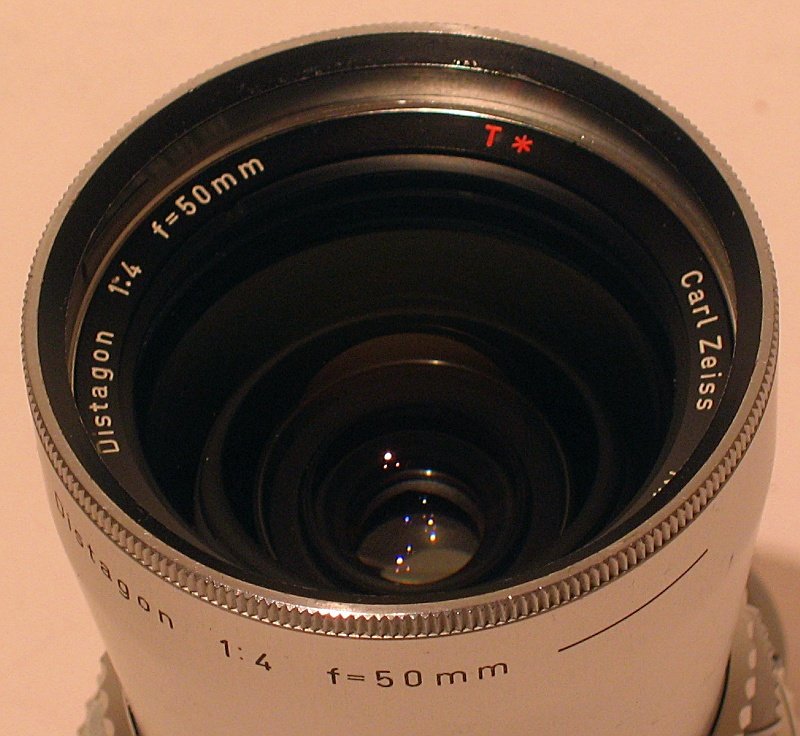

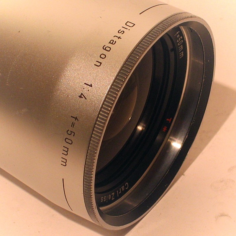

50 mm Wide angle lenses
The 50 mm for the V series starts as a lens with silver barrel and early coating.
Early seventies saw the arrival of T* multicoating.
The silver lenses got T*. Only a limited amount of these lenses were made.
Next step is the switch from silver to black barrel.
All black 50 mm lenses have T* coating.
In 1982 Zeiss changed the barrels again and also fitted a different shutter.
This lens was the last 50 mm WA without FLE.
In 1989 the first 50 mm lens with FLE for the 500 series cameras was introduced.
That lens was later fitted in a different barrel that changed the filter size from B60 to B 70.
To get some idea of the evolution of Zeiss lenses for Hasselblad go to:
http://hasselbladinfo.com/forum/showthread.php?t=3555
Any questions just ask.
Do not forget even the first generation of 50 mm WA lenses are very, very good lenses.
50 mm silver barrel lens with T*, the rare one!
