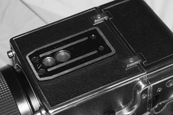

one thing, i am not entirely clear on the later 500cm tripod thing, this is my camera today, is this a later 500cm model? according to the serial number it was made on 1981.
cheers
carlos

No, this is an earlier one than Paul describes. The later models have a stainless steel plate on the bottom that includes the 2 lugs that hold the film cassette.
