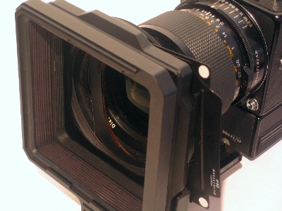

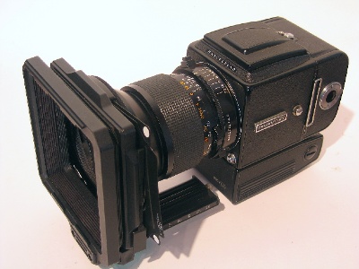

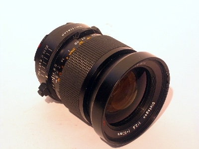

Step 1.
Reduce the lens diameter to 86 mm by removing the lens shade.
This goes for the 40 mm CF/CFE lens and the 50 mm F/FE lens.
For the 350 and 500 lenses the same goes take off the original lens shade.
Step 2.
Remove the filter retaining ring from the front of the adapter.
Open the 6093(T) so that the metal frame can be moved outwards from the body of the pro shade.

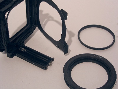

Step 3.
Near the hinge you will find two lips that will allow the adapter rim to be fitted under them.
Push the lock on the bottom LH corner and lock the adapter.
Keep the little screw on the adapter at about 18.30 and lock the adapter to the metal frame.

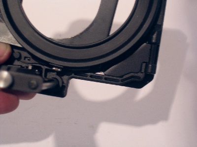

Step 4.
Fit the pro shade to the lens.
If this does not align properly loosen the little screw on the adapter ring and correct the alignment. To do this it is easier to open the hinged metal frame.
Tighten the screw and lock the metal frame.
Fitted proshade correctly aligned.

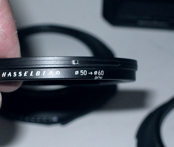

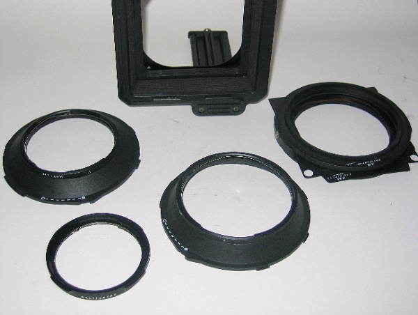

Jason,
Better stop playing with all those rings and pro shades. Keep it simple:
Bottom left: adapter to convert 50 bay into 60 bay part 40711.
Center: adapter for 70 mm lenses part 40744
Left center: adapter for 60 mm lenses part 40741
right center: adapter for 93 mm lenses part 40746
top: pros shade 6093T
With this kit you have all lenses from 50 till 93 mm size covered using only one proshade.
Close up from 40711 the adapter that makes a bay. 60 out of a bay. 50 lens.
Buy and trade with KEH or evilbay. It is easier and less expensive for you.
