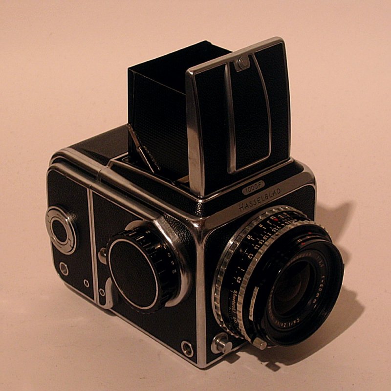

I offer a repair service for 1600F and 1000F cameras.
Anything from a CLA to a full restoration is possible.
For that purpose I have a comprehensive stock of new parts available.
I had the pleasure to service the 1000F camera owned by Wilko and was given the opportunity to restore Jürgens 1000F.
That camera was shown at the forum after a complete restoration.
Before the 1000F Jürgens one owner 1600F was serviced as well as both his Ektar 135 mm lenses.

Paul, Evan,
Parts and expertise are the bottlenecks to service older Hasselblad cameras.
I was lucky to find a large quantity of new parts that often wear in 1600F and 1000F bodies.
Bearings, complete drive assemblies for the shutters etc.
Too much to mention.
Even brand new body shells and all external fittings are in stock.
New parts are the best solution to service cameras.
That means the money spent on labour is well spent.
One owner 1600F now part of Jürgen Loob collection.
Lenses 80 mm and 135 mm Kodak and Carl Zeiss Distagon 60
Fully rebuilt 1000F using many original new parts
Collection Jürgen Loob
