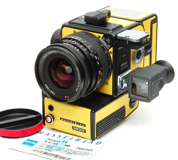

Hasselblad used to make a special camera system that allowed to record images for scientific purposes.
This system used a heavily modified 500ELM body and two special lenses:
A 100 mm Planar lens and a 60 mm Biogon lens.
Both lenses show extreme low distortion.
The camera does not have an auxilary shutter nor does it have a mirror.
Framing is done by a special finder.
The film backs are the only ones without a dark slide!
There is no room for a dark slide since the rear of the camera body holds a special plate with marks that are recorded on all frames.
Think of all the hairline crosses you see on the NASA pictures taken on the Moon with HB cameras. The etched hairlines are on the so called Reseau (glass) plate and allow accurate photogrammatic measurements to be made.
These MK (MessKamera) cameras & lenses are in the superior league in photographic accuracy, well beyond mere mortal stuff like SWC Biogons and the lot ;-)

This MKWE is still for sale on Ebay. I believe it's more or less an SWC with special back and electric winder. Pretty awesome looking camera although asking price is 36,700 USD. Ouch.

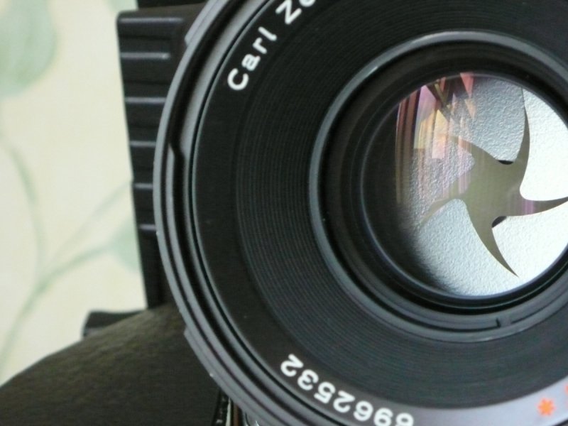

Lens Shutter blades bent
Hi, I received my lens today and apart from a lot of dirt and dust the lens appeared to be in very good condition.
However when I inspected the central shutter two of the leaf shutter blades are bent at the tips, 1 outwards towards the front of the lens and one inwards.
Is this normal? I am concerned that this may cause light leakage and uneven exposure. Also how did the blades become bent - is there a some particle inside the lens assembly?
I have attached a picture to show the shutter and would appreciate any opinions you may have on this.
Regards
Kevin
The bent tips are normal Kevin. They keep the blades from slamming into each other. Hope you enjoy your lens. They are wonderful!
Terry
All shutters are like this one. The 2 leafs folded are longer than others to close the shutter. If they are not folded than the break them self and after few time they are dead.
