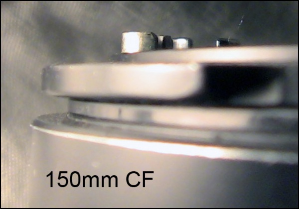

Sorry for the resurrection but .... my CF lens doesn't mount
So everything in this thread, and everything I've ever read, tells me that a CF lens should mount on to my 500C (note: C not C/M) body exactly the way as my C and C T* lenses mount. Smooth, clean, and a satisfying lock-in feel.
But my new-used 150mm CF lens will not mount. Comparing this lens with my other C lenses closely, I see that they are actually not exactly the same. See pix attached (sorry about the cell-phone quality).
Notice with the C lens there is a step up to the bayonet face, but with the CF there is no such step and the bayonet face is uniform across the entire ledge. It "shouldn't" make a difference perhaps, but something is making a difference because I can't mount it.
What do you think?
You say that you have a 500C body?
How old is your (camera) body?
In the first (3?) years there was a pin at 3 o'clock, looking at the lens mount from the front. see attached picture.
And the C-lenses have a hole that corresponds to this pin that the CF and later lenses doesn't have.
If this isn't the case, then I don't know. As all lenses should fit every body.

Lenses can only be fitted to a V series body when they are cocked.
This means shutter and aperture blades are open.
If not use a small coin to turn the slotted shaft at the rear of the lens all the way to the right.
The shaft locks in this position.
The lens can be fitted to any V series body privided the body is cocked as well, meaning mirror is down etc.
The pin Olof B mentioned has no influence on the fitting of a lens.
