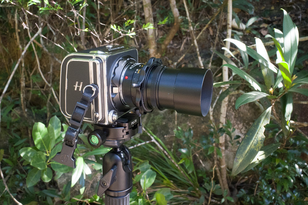

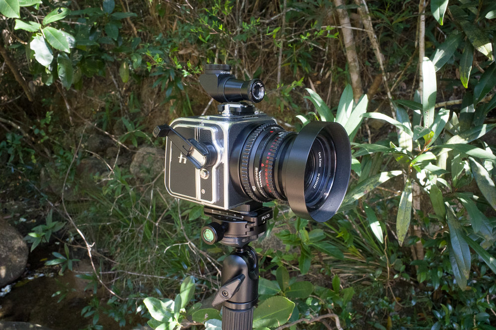

I have, since 2012, been using CFV50 together with SWC/M, 500C/M and (modified) 203FE. One can never be sure what one will get after pressing the shutter. You have to squeeze the shutter with a particular force - not too hard and not too slow. The results have been consistently disappointing. I'll post up some of my failed photos fr your comment.

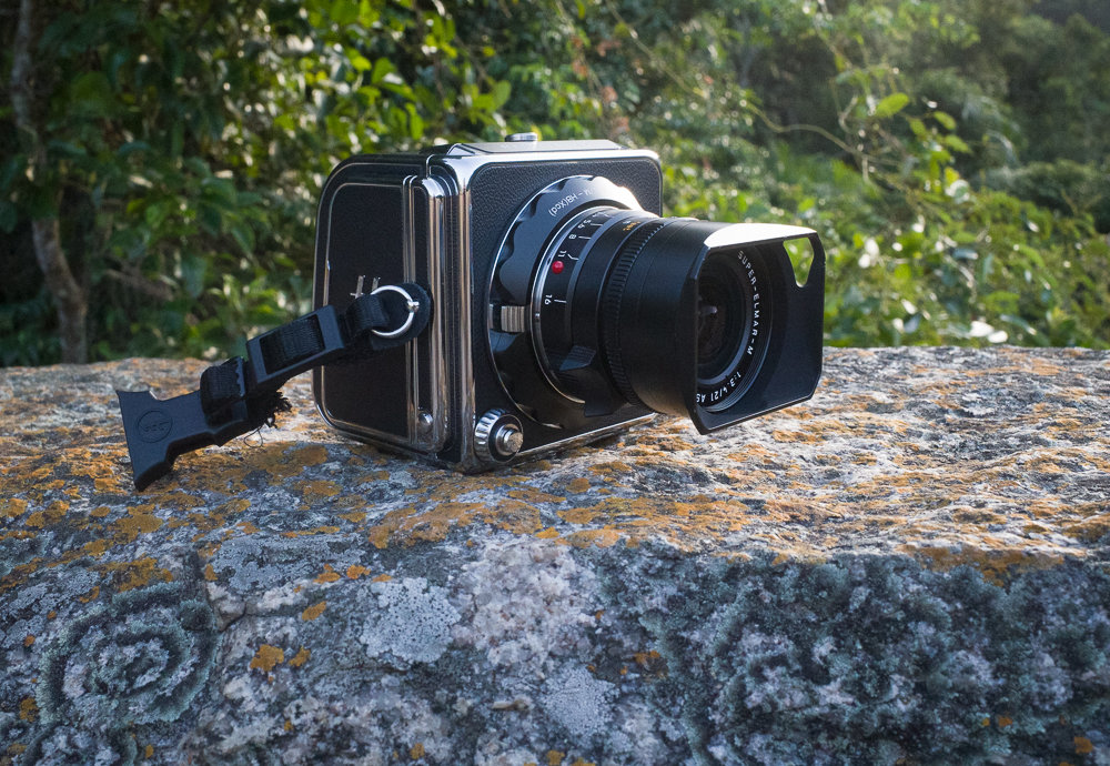

CFV II 50C with Leica Super-Elmar 21mm f3.4 Asph
CFV II 50C with Leica Elmarit-M 90mm f2.8

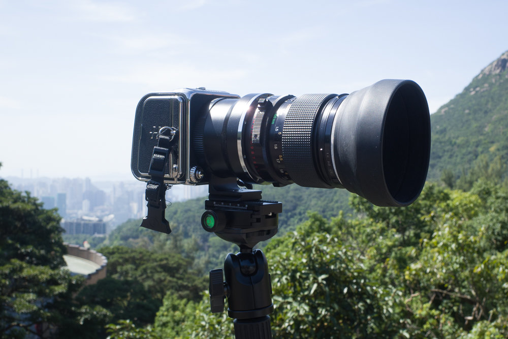

CFV II 50C with Hasselblad 150mm FC f/2.8 Sonnar

Thanks Wengolee for taking all this trouble.
Apart from coverage problems with the 35mm lenses, they look okay to me from a camera/lens point of view. A little distortion on the 150mm that presumably modern firmware would correct with modern lenses. What issues are you having?
The magenta of the 21mm is typical of non-digital ultrawide lenses on digital sensors. Apparently to do with the extreme angle that the light rays are hitting the photosites. I tried a very wide Voigtlander lens years ago on a Kodak professional camera with similar bizarre results. The solution was to buy even a humble wide angle made for digital (in my case a Sigma zoom!).
Interested in what you and others have to comment here.
