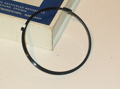

Need some help guys. The aperture blades on my 250 CF lens are stuck open. They will not close down, neither while actually shooting, nor with the DOF button. Any suggestions on a "quick fix" or quality repair shop would be greatly appreciated. I live in Nashville, Tennessee, USA.

Hi Terry, Michael,
Terry you are right.
The small plastic ring that commands the aperture is broken.
The lens needs to be opened so that this part that is located in the shutter/ aperture assembly can be exchanged.
Nothing major but a job best left to a good technician.
David Odess is an excellent choice.
Hi Terry, Michael,

Michael,
It is not a difficult job. Any repairshop with Hasselblad experience should be able to do the repair.
It takes 1-1.5 hours for a trained technician to replace the ring.
I too would rather have the job done by someone local.
Please report what your findings are at Forrest.
