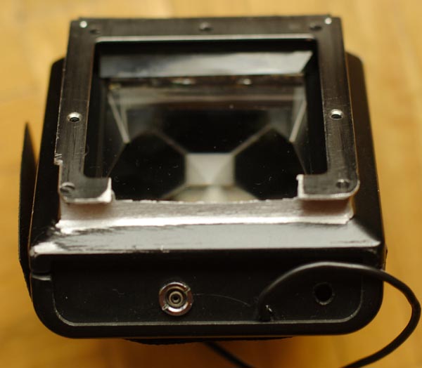

It's impossible to fitt a PM3 on a 203FE. I modify my old PM for my 202FA and it was a serious modification (not only cut !). That makes my PM impossible to resale.

Here is a strong modification of a old PM to be fitted on a 202FA
would u elaborate what did u do with PC outlet and cord sticking out front??
very intersting!
Meir
I add 3 flash contacts on the PM and in the hole there was a switch for the trigger of an integered TTL flash metter. Unfortunaly, the cell was too sensible for IR so I have alway to care ablout the results when I was outside with the mix with artificial light ! The wire fix on lens x-contact.
Then Hasselblad made TTL flash witch works fine.
There was even some contacts for Nikon flash to inform the flash status inside th PM ( 2 leds).
If I have time I will put inside a cordless master for slave-flashes. Why not to put smal removable flash "à la H" witch can help for reportages.
I consider this PM impossible to sell !!
