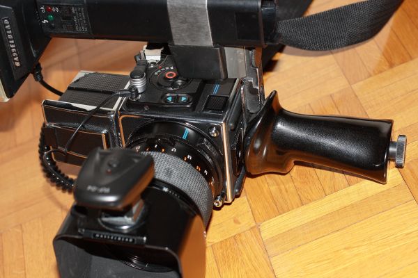

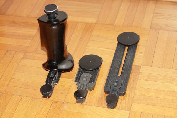

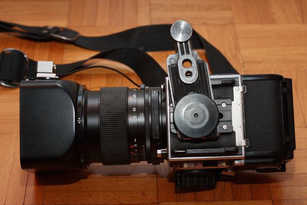

I modified the Metz plates. Far better. Used for years of weddings.
Right to left : original one. One is cut for lenght and for finger. The last on is fixed to an old pistol grip. (Trigger is removed to use with a 500 ELX).
There is an angle to allow to push confortable the button of the 202FA.
BTW, I allways let the plate even if I do not take the Proflash as this plate to handle the body is more confortable. BTW this plate protect the 202 boutton use in the bag: thanks to my battery !
Hand made in Switzerland by my-self 15 years ago: very efficient !
The stuff on the hood is a (low cost) radio flash trigger.
