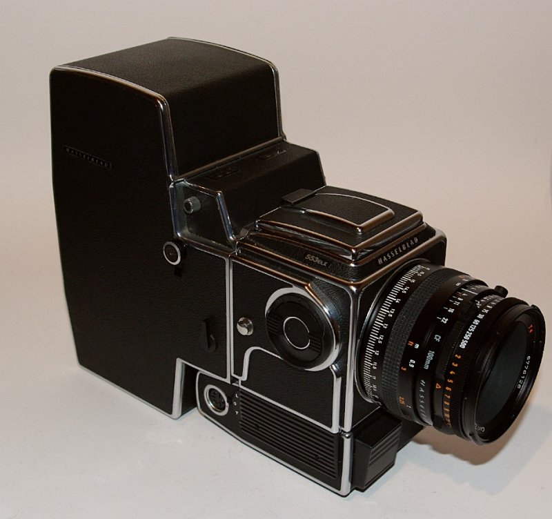

Here is mine:
Bought four years ago, not even near 1500 USD.
This one is in excellent condition, currently loaded with B/W film.
Some 200 frames to go before the film is completely exposed.
I could open the film back and remove the exposed film of course.
Although this back is often shown with an EL motordrive camera the back also works with a 500 CM body.
Power to drive the film transport comes from a battery inside the film back.
With a manual camera it is better to say the camera was connected to the film back!
To avoid confusion with Terries 500/70 back.
Terry does all the work, I am simply trying to help with a service manual.
These large film backs were made in Switzerland during the early seventies.
In those days a new 500/70 film back cost more than three 500 CM bodies with 80 mm lenses and film backs.
