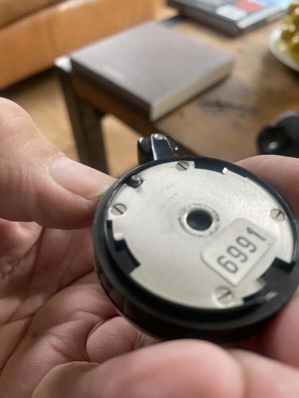

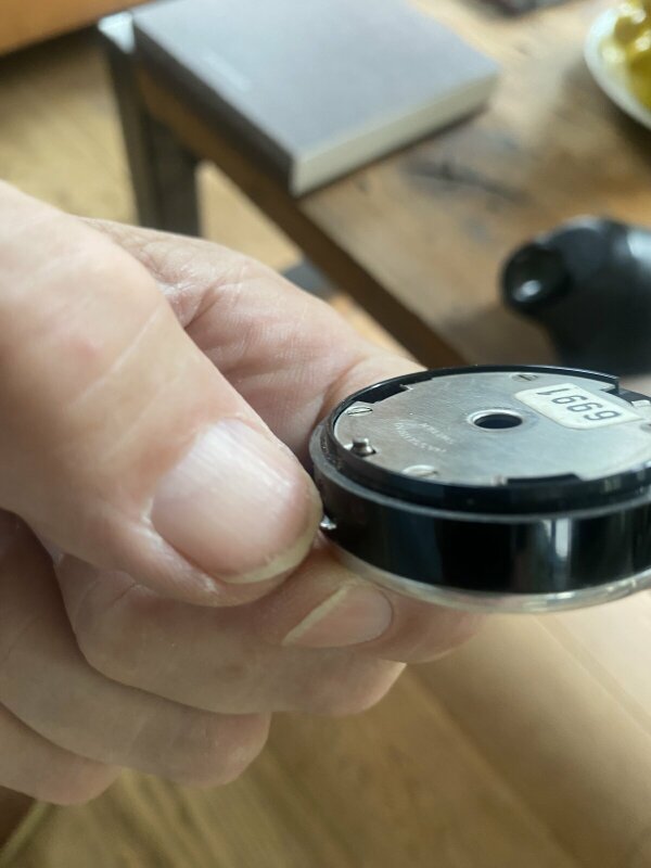

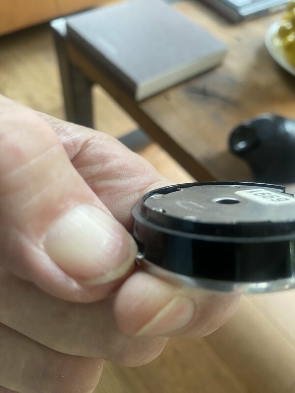

I’m pretty sure that the crank is the problem, check if the little pin comes back properly, there is a strong feather under it!
Hi rien900, thank you for the response. Unfortunately that's not the issue. My crank/ winder has the protruding pin just like yours and locks into the hole/ slot properly. The release mechanism for that pin has plenty of tension which locks it into the slot properly. One of these days, I'll see if I can take a better video removing and installing the winder and better show what the camera is doing.
