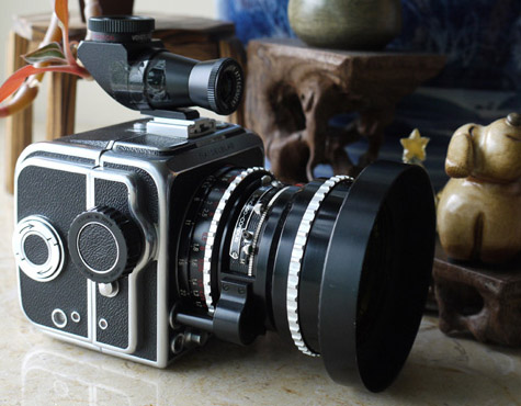

Thanks Jürgen! That's really kind of you. Here is a snap of my SWA.

SWA or SW
Hello Razerx,
If I can trust my eyesight you have an excellent Super Wide camera.
You just escaped from Jürgens hunt for a nice Supreme Wide Angle.
Jürgen found one after a long time only it arrived in a little different condition due to a shoebox wrapping.
Imagine how he felt after the camera turned out to be damaged in transport.
Good news is I found another one in an auction for him.
The Super Wide superceded, a lot of "super"here, the Supreme Wide Angle in 1956.
It has a strong resemblance to its predecessor.
Hasselblad does not seem to have made a point about these diffrences.
For both cameras ther is only one instruction manual.
As far as I know the manual exists in English, German and French.
Ray
Thanks for showing an image of your SW . The camera seems to be in a very good shape . You can be happy .
As Paul already pointed out , your camera is not an SWA (SUPREME WIDE ANGLE , built from 1954 till 1955) but a SUPER WIDE , production 1956 till 1957 . You can determine that by looking at the serial number , which you find at the bottom of the rear end of the camera body , when you take off the film magazine .
Yours will be something like CTxxxx but more likely CUWxxxx .

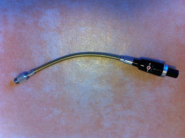

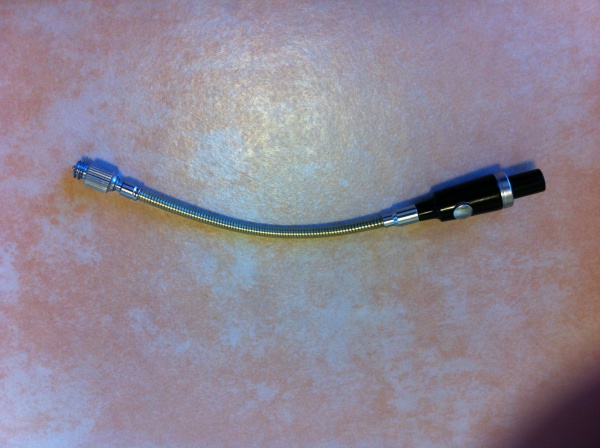

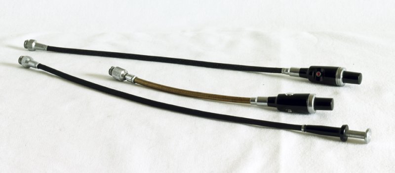

Three types
There were three types of cable release for the 1600F , 1000F and SWA/SW cameras . Unfortunately they are all very short .
For those collectors , who prefer a todays comon long cable release , here among sportsfinders , you can see my clones of the cable release adapter .
