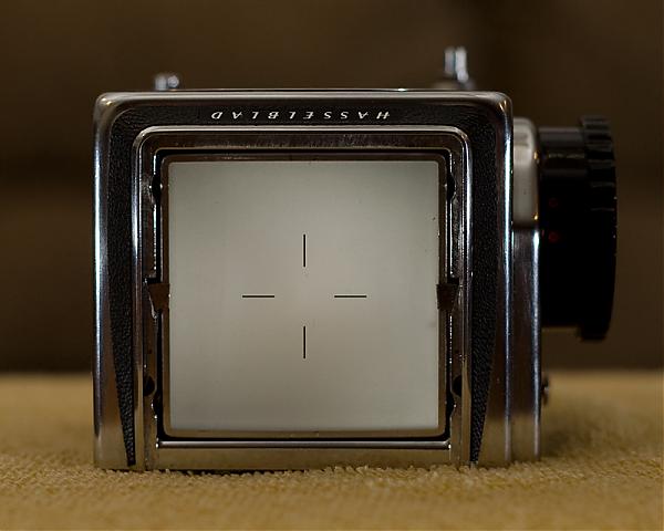

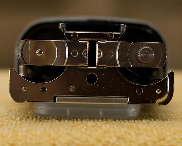

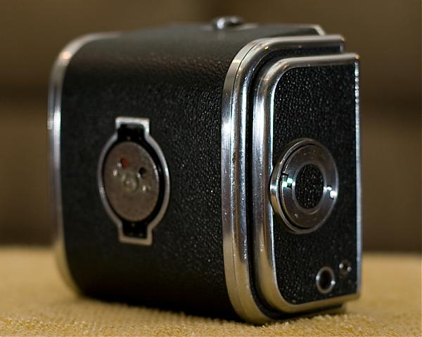

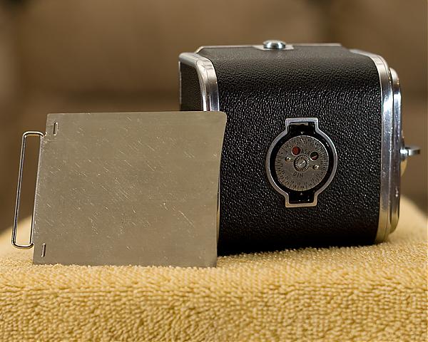

It looks like I have the paperclip in this forum so I can post images but not i the Classified. I am going to post a picture of the of the 500 C/M and C/12 that I am selling off for my first test of posting images here.

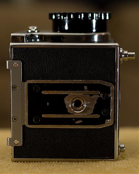

Opps forgot to get the bottom of the 500 CM in there that Poly asked about some time ago. I will add it here.

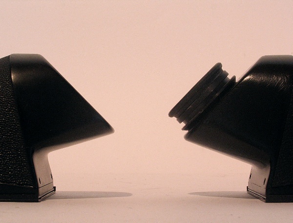

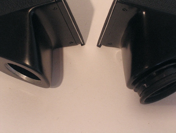

The NC2 and the NC2-100 are quite difficult to tell apart.
Left without eye cup fitting the NC2-100
Left the NC2-100
Measured from the plated ground plate till the center of the curved part the NC2-100 is about 20 mm where the NC2 is only 13 mm.
That difference is enough to clear the Polaback 100.
Finding a fitting and eye cup for the NC2-100 is on my list of things to do.
It is only one of many things that need attention.
Left the NC2-100
I have taken apart the screen on the 500 CM for cleaning and noticed there were two separate pieces of glass in it. The bottom one was the fresnel part. it has its own frame that fits into the top part. If I do it again I will post some images.
I found it interesting that the 201F only had a one piece of glass in it. Paul does your 203FE view screen only have a single piece of glass?

Maybe the text can use some information about asking price for the back and the body. Does the flim back have matching numbers i.e. are they the same for the housing and the insert?
Thanks for taking your first generation screen apart.
Nice to know it also consists of two layers.
As far as I know all Acute Matte screens are twinlayer which makes me wonder what kind of screen you have in the 201F?
