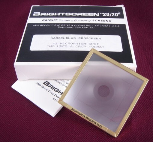

I am about to purchase another screen for my 500 ELM. The one I have is too dim for my 50 Distagon. I saw two that I like but I am confused as to which is brighter or better. The first is made by Hasselblad, called the Hasselblad Bright Screen. It has a clear looking spot in the middle. The second looks identical but is made by BRIGHTSCREEN. Which is the brighter? I like the center spot better than a split image.

US made Bright Screens have a good reputation and will do the job well with any Hasselblad camera.

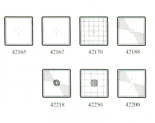

Hasselblad supplied grighter screens made according to Minolta patents.
The first generation of these screens are called Acute Matte.
The later improved version is called Acute Matte "D"
D screens can be recognised by two small cut outs in the metal rim looking like a "D".
The improvement of the D screens lies in easier focusing in brightly lit subjects.
A selection of first generation Acute Matte screens.

Vic, I bought a Brightscreen brand on Ebay for $119. It is mint. I called Brightscreen and they wanted more than twice that for the same one new.
Here is the one I got. I am sure it will make focusing the 50 Distagon much easier.
I forgot to ask the seller if it is easy to install. I guess it just drops in and you close the two side sliding retainers. Do you know which side it up or are they the same on both sides so it does not matter?
Well done!

Thank you Vic. I also just ordered a 100 f3.5. I have another question so I am posting it in another thread.
