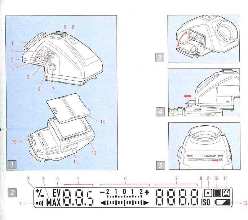

Just to be sure a few copies from the PM(E) manual that describe how to adjust the eyepiece.
The PM(E) 45 allows for adjustment to the vision of the user.
Before anything this needs to be adjusted for correct compensation.
If you can not get a clear view by adjusting there are other lenses available to enlarge the range of correction.
The standard lens will do in most cases.
