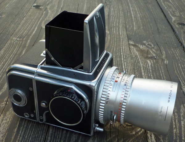

Thrilling thread, so I join the club: my 500C is CU30654. Got only the body with a later finder, ordered the hopefully right one (1600/1000 style), found a back fom 1959 in good condition, so quite well fitting and bought a 4.0/150 (5140938, I assume around 1970) for a first test. Will start next weekend to take photos with that early beauty.
As soon I learn to post photos here I will attach from this 500C. BTW I cannot open any attachment, as the one in this thread. Always get this message: "Invalid Attachment specified. If you followed a valid link, please notify the administrator".
With kind regards from Austria,
Walter
yes but twice, could not correct this. The lens is 4.0/50 of course (sorry my mistake) and detail photos should come next weekend. The body has all the destinctive features for 1957.

looks great :) and good to use certainly.
