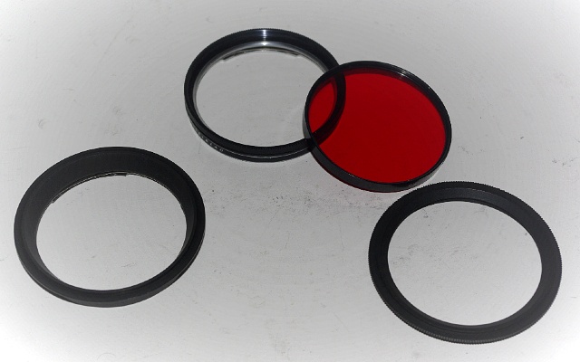

The first picture shows from left to right:
A bay 50 ring that you probably have to connect the compendium with B 50 lenses, the adapter and a 63mm filter that allows the use of 63 mm inlay filters with B 50 lenses and a ring to connect this adapter with or with out filter to the compendium

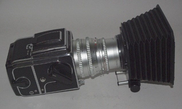

500CM with 150 C lens and filter adapter fitted to early compendium.
There are also rings to fit this combination of lens and filter adapter to later compendiums.
It probably sounds more confusing than it actually is.
63 mm inlay filters are used with lenses that have a 67 mm thread.
Be careful not all 67 mm threads are cut in the same way.
There is coarse and fine thread as well.
Finally forget Cokin filters. They are not up to the quality of Hasselblad system lenses.
Whatever way you decide to go stick with Hasselblad (B+W) or Heliopan filters and forget the rest.
