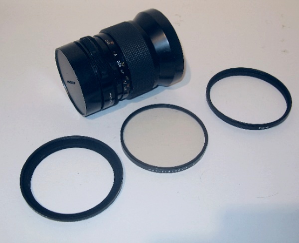

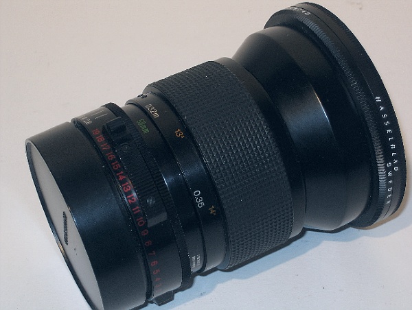

50/2.8 F lens with shade and retainer ring fitted.
lens with shade, inlay filter and retainer ring.
