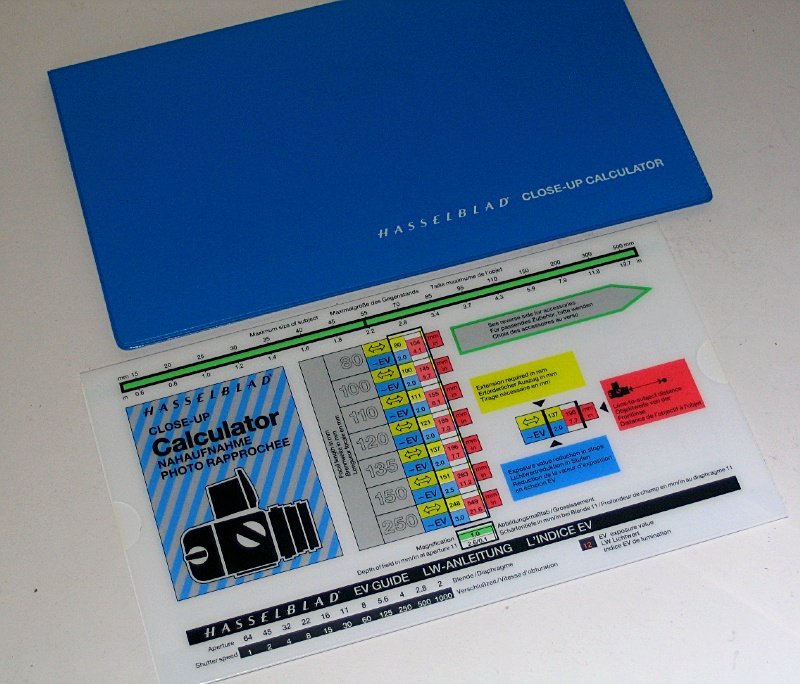

Close up calculator
This article was once available as a nice booklet from Hasselblad dealers.
Some may still have a copy or try any of the auction sites to get one.
Hasselblad used to make a special sliding ruler to find all variables that are important with the use of extensions.
Any extension be it fixed rings, the variable extension ring, the bellows or any combination can be found in this ruler.
It gives distance, EV correction, and reproduction scale of the objects.
Keep in mind this is all for 6X6 of course.
You might find this calculator in the classified section!
I can't understand the table at all, but i will try to compare it with Canon Extension tubes so i can understand those numbers.

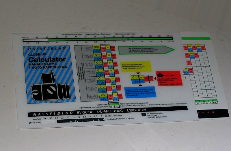

Macro Calculator
The slding ruler is not a static list.
The inner part can be moved to show data for a given distance or scale and size of the subject.
It is a clever device that allows you to find the right lens/extension for a given macro task.
Close up calculator
The calculator is not a table or sheet it is a sliding ruler.
The calculator gives all variables for a given lens and a subject varying from 15 till 500 mm to record that subject filling the film frame completely.
You will find: extra extension needed for any lens from 80 mm till 250 mm, distance from subject to the lens, correction factor for the exposure, and magnification factor.
The calculator even gives information about the lens extension itself in these cases.
In short all variables are found once you have selected the actual size of the subject.
This calculator was designed for 6x6 film frames but it can also be used with 6x4.5 using a correction factor.
