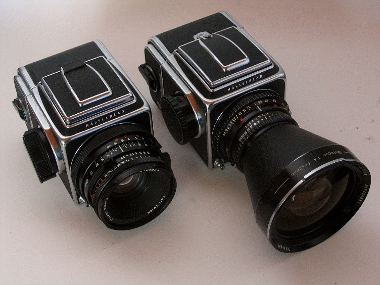

Two times 500 CM left with 80 mm CF, right with early non T* 40 mm C lens.
