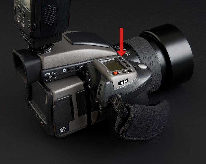

My reference regarding control without taking your eye from the camera is for use of on-camera or on-flip-bracket fill flash when working quickly and spontaneously ... like when photographing a wedding (which is how I frequently use my H3D-II/31.)
You will need the camera in hand to understand this: while shooting you can press the flash control button on the grip with your forefinger (see attached photo of my H3D-II/31), then rotate the front command wheel to change the flash compensation value ... this +/- value shows up in the viewfinder ... so, with a little practice, you can do this without removing your eye from the viewfinder. If you wish to also alter the camera exposure value +/- you press the button on the Prism Finder with your thumb, and rotate the command wheel.
Go to the Metz web-site if you want to control multiple off-camera flashes. I do not know much about this because when using multiple flash units I don't use an inferred system like the Nikon SU4 or Canon STE-2 units ... their distance is too poor, and they are easily blocked due to relying on line-of-site communication.
My preference is to use small Hensel strobes and the Hensel wireless radio system which allows you to alter the output of strobe heads from the camera position. Elinchrom Sky-Ports also allow radio control of each strobe head from the camera. IMO, this is much more useful than retaining TTL flash control.
I wish Pocket Wizard would address the at-camera control issue for ProFoto strobes ... right now, you have to go to each mono head and alter the value ... which is a big PITA if the head is enclosed in a light modifier, or 12 feet up in the air.
