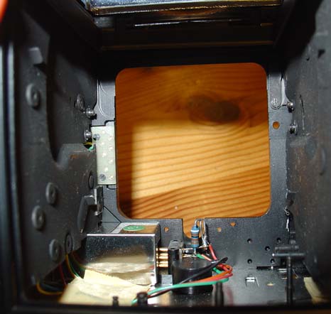

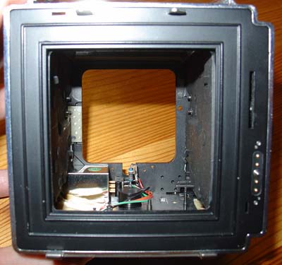

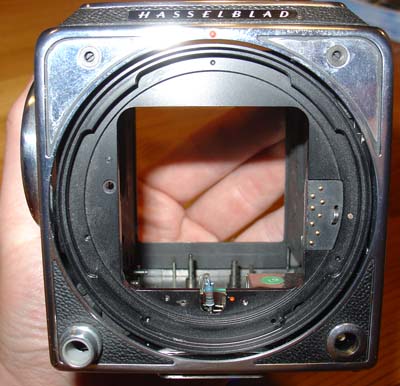

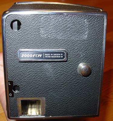

Hello friends,
I bought an interesting relict. On first view it looks like a Hasselblad 2000 FCW wreck. In fact it appears more to be a test camera because it contains data bus contacts at the front and at the rear. Note that there is a double row of databus contacts in the lens mount. Paul did already tell me that he once saw a F-lens with corresponding contacts. This is unfortunately not a fully working camera, many parts like the mirror and the shutter assembly have not been installed at all or removed for the tests (I do not know yet). It does not have a serial number.
Does anybody have an idea what the additional contacts might have been used for? Are there any other development cameras in the hands of forum members?

This is a fantastic find! Now I know what an archeologist feels like when they find a rare relic. The rear contacts look like the ones on my 205tcc with maybe an extra contact top and bottom. The front outer contacts look like the lens mount ones with an extra row near the center. Where did you come upon this?

Apparently somebody at CZ decides to clean out some stores and things like this prototype body are on their way out.
Take a look at your 350 lens and you will see it also is ready to accept extra contacts.
Not only your lens but also some 110 mm lenses exist with the same rear
bayonet plate that allows for extra contacts.
My guess is they were meant for an autofocus system that never went into production.
Carl Zeiss engineers had a working AF system for the 500 or 200 series cameras many years ago.
This system was shown to Hasselblad executives who decided the world was not ready for MF AF.
That decision lead to a less friendly relationship to put it mildly.
It also changed the course of history but that is a different matter.
Let see at the next dustbin to find a AF lens for this camera !
Or a lens with electrical central shutter.
Or electrical to inform the speed of the central shutter selection that allow to have full automatic ttl mesuring.
Perhaps the missing contacts to use CFV back without any modification and help keeping the asa information with classical back !
I guess that when this prototype was made nobody at Hasselblad had digital photography in mind. It should be from the late 1980ies.
Hasselblad recognised the possibilities of digital caption as one of the first MF manufacturers in the world.
The Leaf DB 4000 digital back was available for Hasselblad cameras as early as 1992.
Ulrik is correct that the 2000 FCW experimental body is a little older.
These early backs did not allow the use of focalplane shutters.
The CFV is the first digital back that allowed the use of 200 series cameras after modification.
