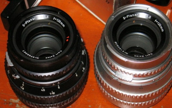

I have both the silver non T* and the black T* model of the 120 S-Planar.
The silver version is the lens I use most of the time.
Are these what you are all refering to?
120 S-Planars
Hi Terry,
Yes these are the lenses we are talking about.
Your black lens is an early one being from 1975. It is one of the first black T* S-planars.
The silver S-Planar is from 1969.
Both appear to be in excellent condition!
Hi Paul,
Physically they are both very nice. They are however waiting their turn to go to the shutter doctor to restore some of the slow shutter speeds!
