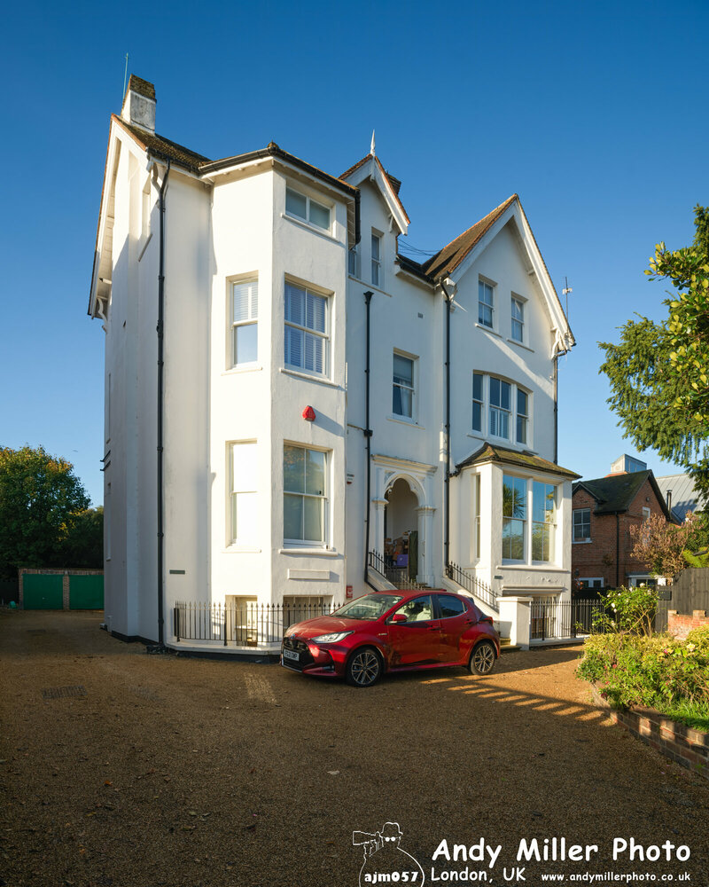

a) camera horizontal, in portrait orientation with an "overly accurate" vertical shift down of the camera standard to ensure all vertical lines/geometry are aligned to correct the perspective.The final image was assembled from 5 shots using horizontal shift of the camera to vary the point of view (increasing horizontal coverage) and then merged in LRC as a Pano. The guidance is too ease back from using a vertical shift that provides a technically correct image, otherwise, as can be seen, this technically correct shot looks like the building is getting wider as one looks up - it is not in fact all vertical lines/features are "perfectly" parallel.

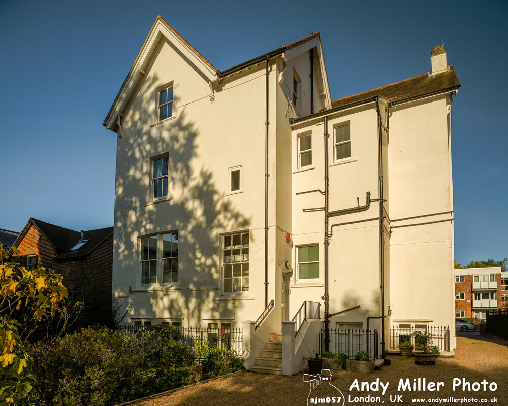

b) The 2nd image was taken with the camera rotated into landscape, aligned horizontally and then shifted down to correct the perspective. The final image was assembled from 3 shots taken with exposure bracket to expand the dynamic range and then merged in LRC as an HDR. [Yes the white balance was played with to warm the building in the setting sun and the sky was also adjusted - shot was taken with a CPL, which needed to be backed off from 100% to probably 50% of perfect alignment].

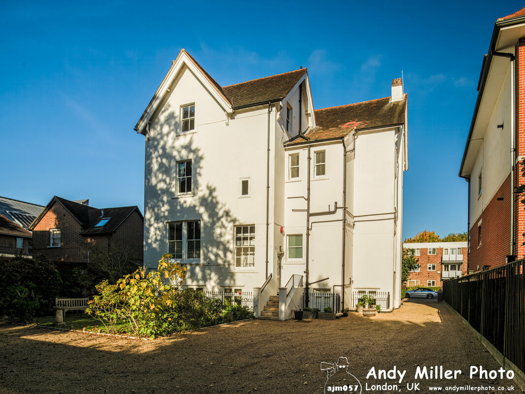

c) The 3rd image was taken a little earlier and with a different vertical shift. No adjustment to white balance.
