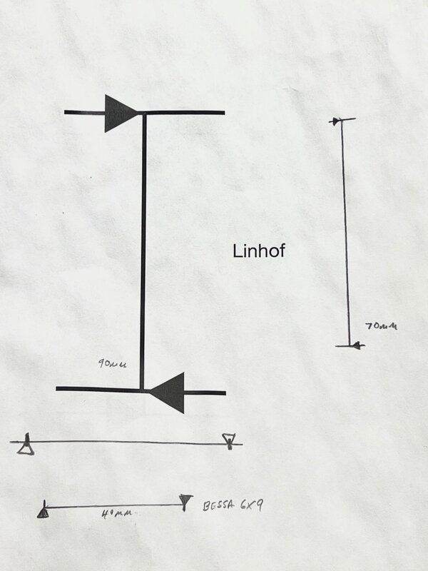

An easy trick to check infinity on any rangefinder is to draw a line exactly the length of the base of the rangefinder (the distance between the two windows) On any Linhof's in particular, the distance will be an even number, so don't be concerned about your measurement being un-accurate - it is NOT an uneven number. My 4x5 and 5x7 Technikas are 90mm - my III series medium format ones are 70mm.
Draw a line on a piece of paper as accurately as you can that exact length. Put arrow shapes on each end (see pic). At infinity, the two arrows will line up opposite each other - at WHATEVER distance this paper is placed away from the camera - distance from the camera to the paper is not relevent, the length of the line is what is important. If the arrows do not line up, then the infinity position of your cam is off.
You can then check your ground glass on the perfect infinity target (the moon) to see if your ground glass is correct.
