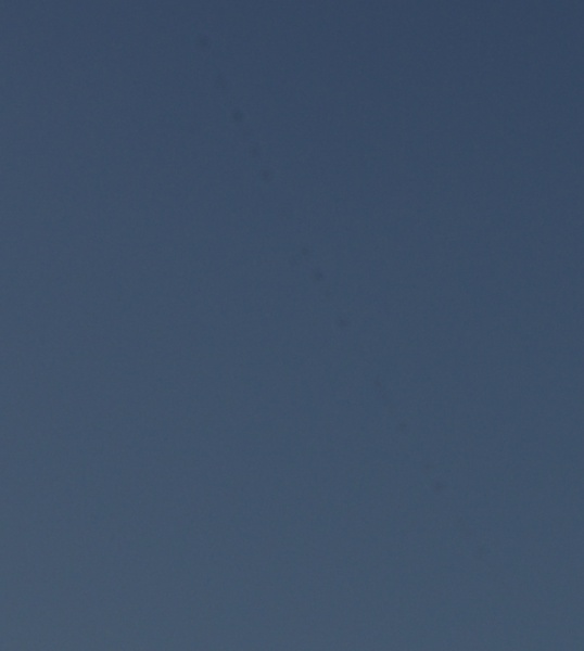

Thanks Thomas,
i'm posting the portion of the sensor whit the problem.
it looks more like dirt imo.
what do you think?

Hi Anto,
I must say it is hard to make an assessment based on this low res jpeg.
Have you cleaned the IR filter? Can you determine if this on top of the IR or beneath it?
If you let me know what country you are in, i will direct you to one of Hasselblad's subsidiaries or partners.

hi Paul,
i cleaned the sensor , but the marks didn't came away, so in my opinion they shoul be under the glass.
I live in Italy and since i'm planning a trip next fall, i would like to send the camera to service when i'll be back.Fungus?
