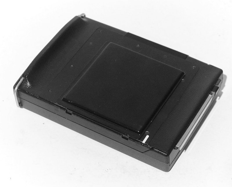

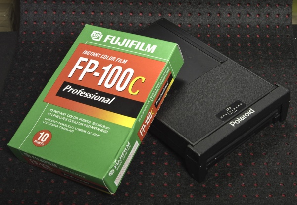

I am using Hasselblad Pola 100 polaroid magazine back and currently using Fujifilm FP-100C color print film. FP-100C has format of 3.25x4.25", but with Hasselblad polaroid backs only 55x55mm can be used, and has sensitivity of ISO 100.
The last Hasselblad polariod back is Pola Plus 100 magazine back; the only difference is a safety catch at the darkslide that prevent accidental exposure. As there is not enough back focus for polaroid image plane, there is a glass window between the camera body and the magazine to extend the back focus. This make the edge a little blur and has to be extreme careful in handling.

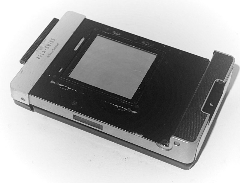

It is not my habit to show what you should not use but here are two backs you should not buy because there is no more film available for these backs.
Arca Swiss back
These backs use Polaroid 663 film that is no longer available.
