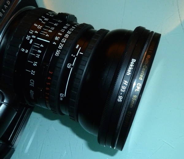

It took a while since I'm in China, but it looks like there are reasonable solutions for fitting polarizers (and other filters) to 40mm and 50mm lenses.

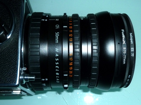

Bay 70 to 77mm adapters are readily available; attached is a photo showing that adapter coupling a 77mm filter to the Bay 70 mount on a 50mm. Vignetting does not seem to be an issue, but it's difficult to fit a lens shade.
The 40mm presented a more difficult problem. 93mm polarizers are expensive.

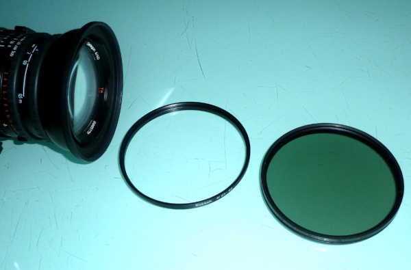

The earlier suggestion was to use an 86mm to 95mm adapter so more common (i.e. less expensive polarizers) could be fitted. This set-up does not
permit use of the supplied lens hood. This hood has a 93mm thread, and I wanted to use the hood. It was a challenge to source a 93mm to 95mm adapter, but they are available. The set-up does not appear to vignette.
