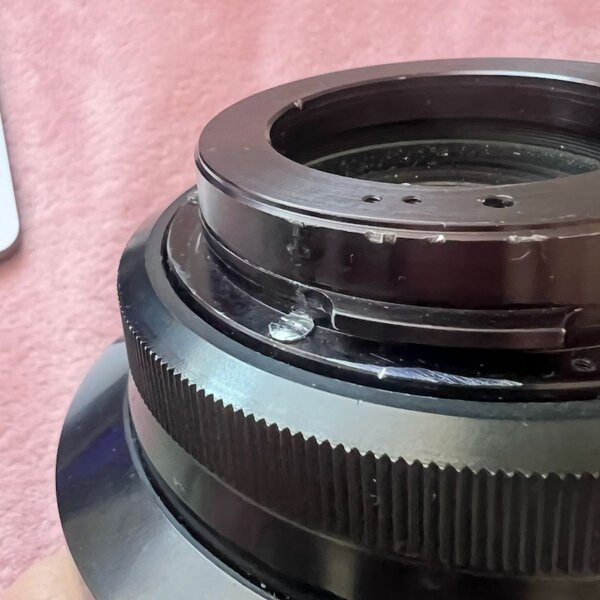

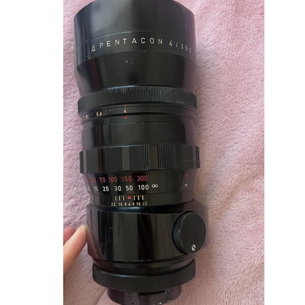

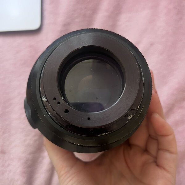

I’ve got a Kiev 6C - which has a Pentacon Six mount and a few years ago picked up a Pentacon 300mm f/4 (Orestegor). The lens looks to have an interchangeable rear mount system.
Here’s the issue:
  • The lens has bayonet lugs, so it’s not just a flat plate or M42 thread
  • But when I try to mount it, it feels slightly too small
  • It won’t properly lock into the camera, other lenses on the camera lock in just fine
  • The locking pin on the body doesn’t align or engage properly
  • There are 3 small screws holes on the rear mount and one larger one, but that hole doesn’t seem to match the Kiev’s locking pin
  • The 3 larger screws on the base are also soft metal and with age are nearly entirely flat meaning that they are also hard to remove so close to buggering it.
So I’m trying to work out:
  1. Does this sound like the lens has the wrong mount installed (e.g. Exakta or something else)?
  2. Were there multiple interchangeable mount types for the Orestegor 300mm that look similar to Pentacon Six but aren’t?
  3. Do I need to source a specific Pentacon Six mount plate, and if so, are they interchangeable across versions of this lens?
  4. Any suggestions on how to remove this, I think the correct P6 mount is beneath this plate.
I’ve attached photos of the lens: flat screws and rear mount for reference.
Appreciate any insight — don’t want to force anything and damage the body or lens.
Thanks!

I'm unsure, it was advertised for the camera I have (Kiev 60/Kiev 6C) as a P6 (Pentacon six) mount, but I think its not the correct mount so I'm not even sure what I'm looking for!
You appear to have a Frankenstein mount on your lens - very nasty soft metal with some dodgy screws... I don't know if this may be part of the solution as you mention a bit of play: check out this item and especially its description: Despite Russian attacks, the company is still manufacturing and trading and even if the Arax Upgraded Mount Ring is not the solution, they may be able to give you some advice. I have found them very helpful in the past - admittedly pre- the Russian invasion of Ukraine
