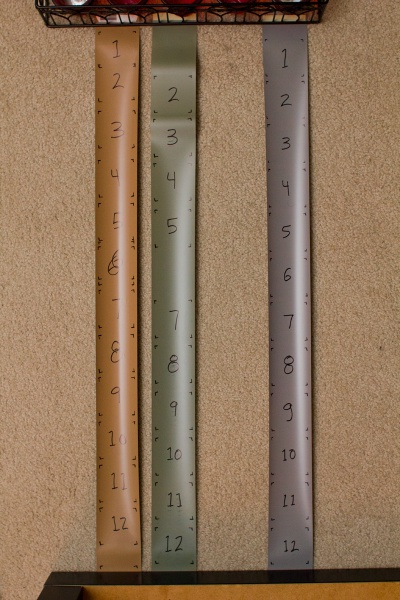

Alright, I did a little test today with the bad A12 back against one that I know works properly. I threw some rolls of film through some magazines and marked where each crank advanced to on the film with corner markers and the frame number. Took a picture of the results and that's what you see below. It might be hard to see so you can find a larger version of the image here.
The two rolls on the left have been advanced through the bad back. The one on the right went through a good back. As you can see on the first roll, shots 1 and 2 overlapped. Shot 6 didn't advance very much at all. The second roll didn't have any overlap but the spacing was very inconsistent. The third roll which went through the good back, had no overlaps and consistent spacing.
I'm sure I went overkill on this, but I wanted to be sure I could recreate the problem and also prove to myself that the body was fine and the service I just did to it wasn't a waste of time and money.
Thoughts?

Film backs are the part of the system that wears most.
They are also the most vulnerable part.
A film back that is dropped is almost certain out of alignment.
Backs that have been used for a couple of years and were treated with care could do with a tune up.
